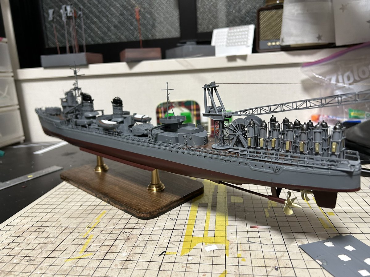

想對付哥吉拉也是不能裝艦尾砲(有雷) https://x.com/9nKWrooW6ThoBgy/status/1723630529151639900?s=20 https://pbs.twimg.com/media/F-uQ1FcbQAEnbTy.jpg
