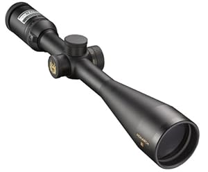

我有錢買帝寶就捐槍救國軍啦!再買同數量同單價$500的Nikon MONARCH 3瞄準鏡*3*4都還有剩呢!
*3:
http://www.amazon.com/dp/B00BAHMGGI
Nikon MONARCH 3 BDC Riflescope, Black, 4-16x50
Price: $496.95
*4:
http://bestriflescopereview.com/best-rifle-scope-under-500/
2015 The Best Rifle Scope Under $500
1.Carl Zeiss Conquest MC Riflescope
2.Burris 200433 – FF Fullfield TAC30 1-4 x 24 with Fastfire II Scope
3.Nikon M223 BDC 600 8489 3-12 x 42SF Riflescope
4.The Vortex Viper PA 30 mm Tube Rifle Scope:
5.Nikon Buckmaster 4.5 – 14 × 40 Rifle scope:
6.Nikon Monarch 3 4 – 16 x 50 mm Side Focus Rifle Scope
