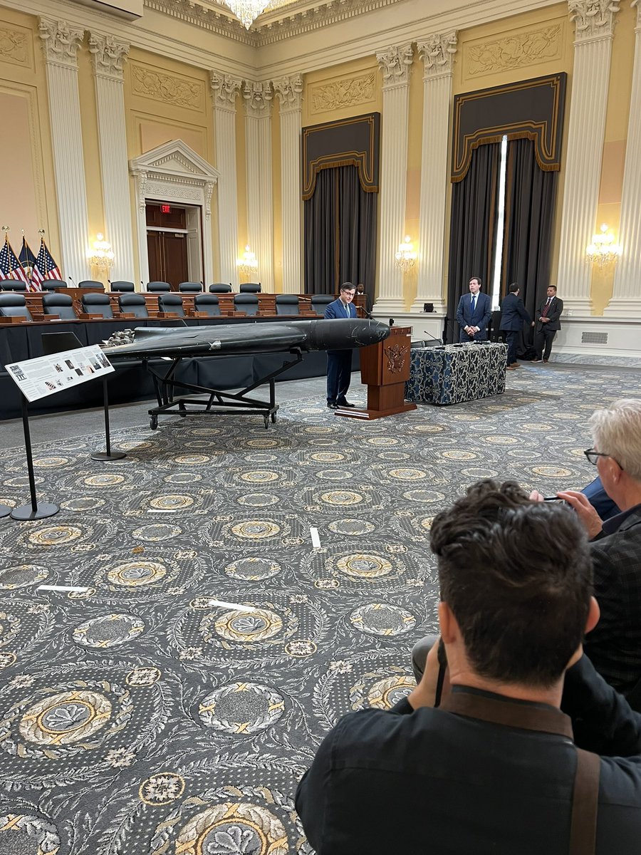

"Shahed"無人機,比想像還大台不少.
