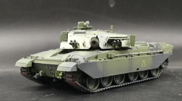

¸Ü»¡¤é¥»¤H»Ä¬D¾ÔªÌ¤@ªº¼ö¹³®g±±»ö¸Ë¦b¯¥¶ð®ÇÃä¬O­^°ê­±
¥i¬O§Ú¤£À´¸Ë®ÇÃä°£¤F¥i¯à¬O¨¾¿m®zÂI¥~¦³¤°»ò¤£¦n¡A¦pªG»¡¤£¯à¿W¥ßÂyÄ誺¸Ü¨º¬D¾ÔªÌ¤G¸Ë¯¥¬Þ¤W¤]¦n¤£¨ì­þ¥h°Ú...
28916 Posts
Posted - 11/14/2018 :  20:41:03  ·|­û¸ê®Æ Send ·V¡D¤¤³¥ a Private Message  ¤Þ¨¥¦^ÂÐ
­^°ê­±ªº¤j­P©w¸q¡G
©Ê¯à­±½T¹ê¸Ñ¨M¤F°ÝÃD¦ý¬O¥~Æ[«Ü©_¯S¡C
45¦¡ÅX³vÄ¥
Avro Shackleton¤Ï¼ç¾÷
°{¹q¦¡¾Ô°«¾÷
¬D¾ÔªÌ1¦¡¾Ô¨®
